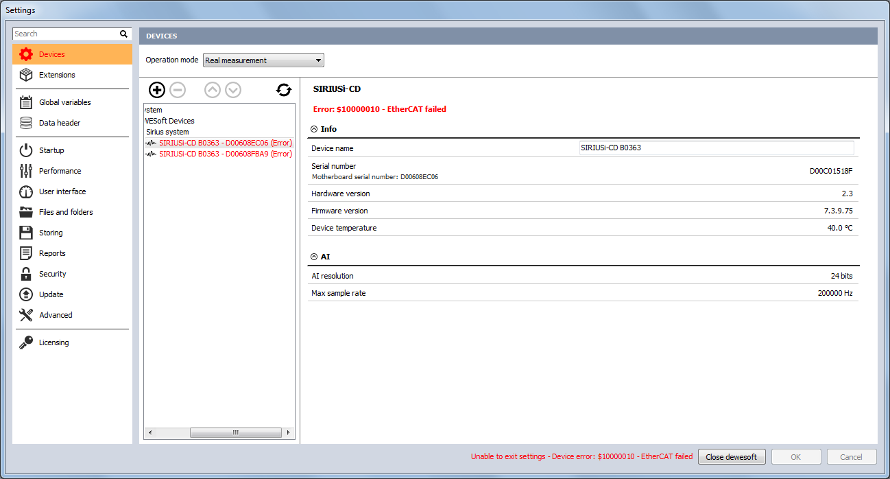

I upgrade the firmware of a Sirius i-CD with the latest one (03_29_2017) and after the upgrade I receive a weird Device error "$10000010 - EtherCAT failed".
Can you help my to recover this sirius ??

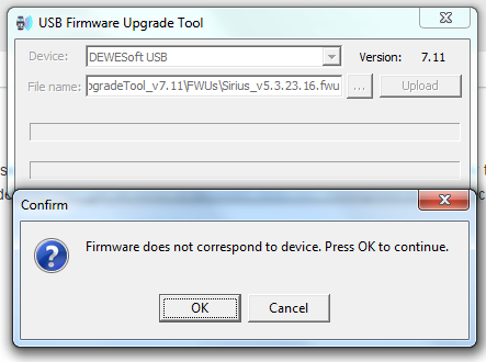

I had already try to downgrade to the previous version (11_23_2016) Nothing happens the error remain there. Also I try to downgrade to a very old version Sirius_v5.3.23.16.zip using the USB firmware upgrade tool, but I get a warning of "firmware does not correspond to device" and I do not continue it.

the warning you got was correct, because the Sirius firmware with .16 at the end is for the basic Sirius-i device, but you have a SiriusCD, which uses firmware with .75 at the end.

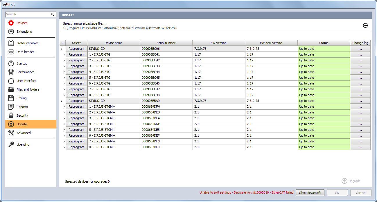

I uploaded the 7.3.9.75 fwu file on our web page. Can you use the USB firmware upgrade tool with that file and that still doesn't help can you send me your TeamViewer information on our support mail (support@dewesoft.com).

I try this firmware but nothing change, the error remain there. I have sent the TeamViewer ID by e-mail.
