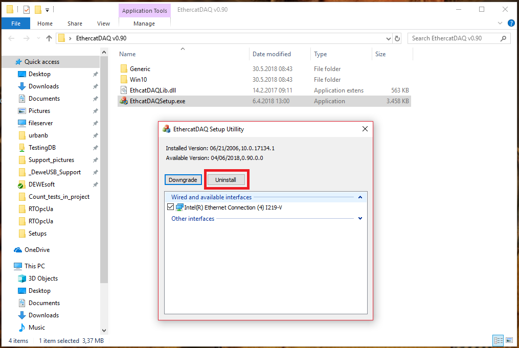

I was advised to install a new version of the EtherCatDAQ drivers. I need to uninstall the previous version first.
How do I do that? I cannot find an uninstaller. Should I delete the EthcatDAQLib.DLL in the BIN\X2 folder, or is more work needed?

Hello,
the uninstall is in the setup. Download the EthcatDAQ v 0.90 and run the EthcatDAQSetup.exe there you will have the option to uninstall.
If you have any other questions about the installation feel free to ask.Attached files:
