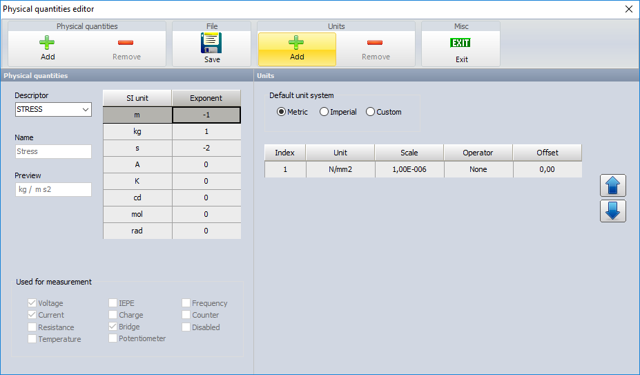

- change the units of stress from N/mm2 to, say, MPa (OK, it's the same thing, but some of my customers prefer MPa...) or other?
- add to the materials list - e.g. Super Duplex Steel with a Young's Modulus of 190 GPa (perhaps there are other properties that need to be considered e.g. coefficient of thermal expansion)
you can add custom units in the "Physical quantities editor". It can be accessed through the settings tab. There, you're able to choose between Metric, Imperial and custom units. You can add a specific unit for a specific physical quantity, just make sure that you enter the correct scaling. You can even choose the order in which the units will be shown when using that physical quantity. The first one on the list will be the default unit for that quantity.
