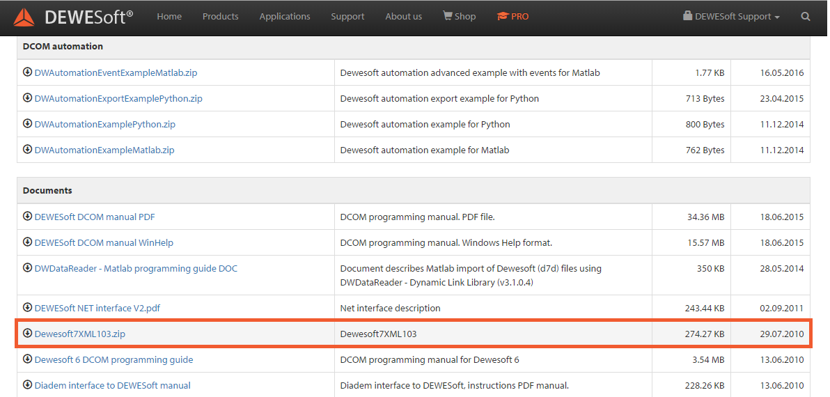

I recently found that one can export a test's DEWESoft XML setup file when exporting DEWESoft dxd files to .MAT files. I was wondering if there was any information on the setup file. Page 433 in the DEWESoft X1 - User Manual states that there is a XMLFileStructure document that contains detailed information about this file, but I have been unable to find it on DEWESoft's website. I was wondering if there was anyone that had access to this file that could assist me. Thank you for your time.

the document exists, but finding it can be a bit difficult. It's located in the developers section of the support tab. You'll have to be logged in if you wish to see/download it. I've also marked it in the attached picture. Just as a side note, you can actually also get the .xml document from any setup file directly, all you have to do is open it as an archive, and you'll be able to see the file.
Thanks for the quick reply. This is exactly what I was looking for. I appreciate the assistance.
