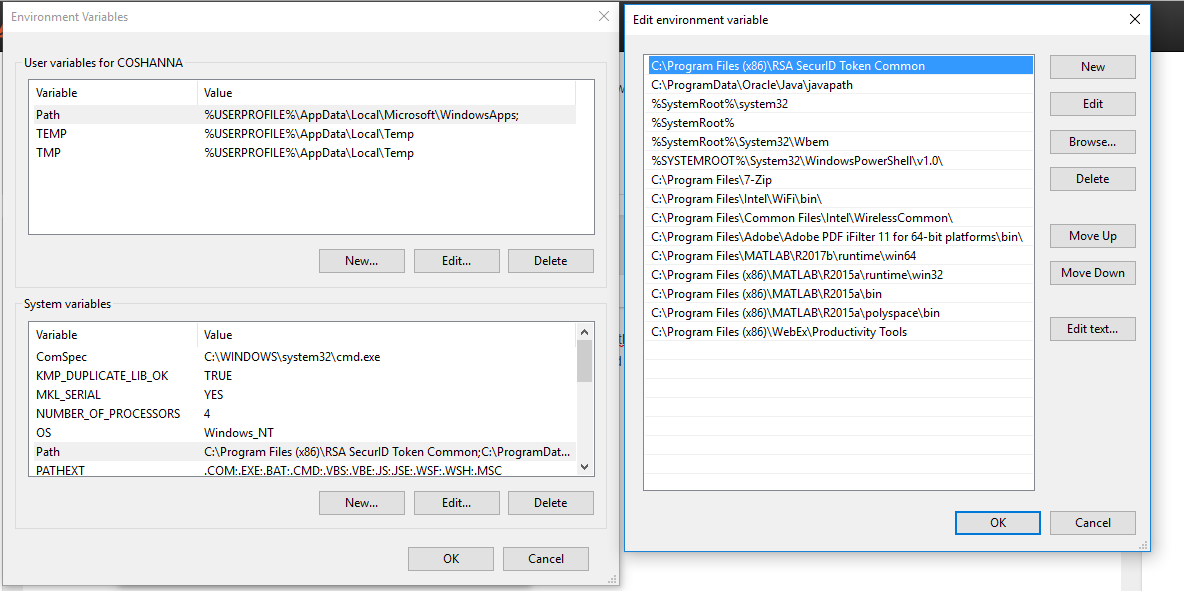

I'd like to get the regular export working first. Your environmental variables need to include a path to MATLAB\...\win64 (or 32 in your case). Please check your path variables and if that path is not present, then you should add it manually. I've attached a screenshot that you can use for reference to help you locate the correct variable section.

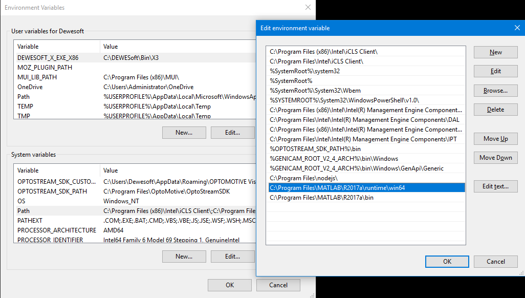

I've mostly been getting around this by exporting on a machine that has a 64bit version of matlab installed as well. But I still cannot export from 64bit X3, with only a 32bit matlab install - even when trying to use the 64bit libmat.dll file. I've created a directory to hold libmat.dll at "C:\Program Files\MATLAB\R2017b\runtime\win64" and added that directory onto my system Path variable, see attached screenshot, but I'm still getting the same error message when trying to export.
you unfortunately won't be able to use the MATLAB export if the bit rates of DEWESoft and MATLAB don't match. You need to have a 64-bit MATLAB if you're using a 64-bit DEWESoft, and vice versa.

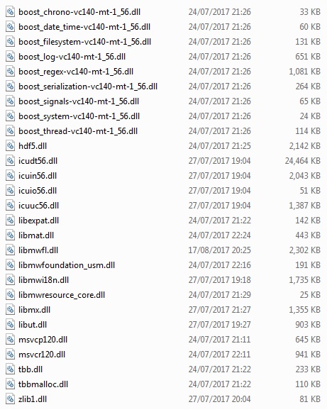

After some further analysis, we've compiled a list of necessary dlls which enable the export even if you don't have MATLAB installed on your local machine. You can find it in the attachment. The dlls need to be located in the same folder as DEWESoft.exe.
I install the demo version of MatLab 2017b on my machine and the export works properly.
Then I moved the dlls you list to the Dewesoft folder and I removed MatLab, but the export stop working. Some dlls I found in the MatLab folders had a different version (….-vc140-…. instead of …-vc120-…); you can find the list the attachment.
