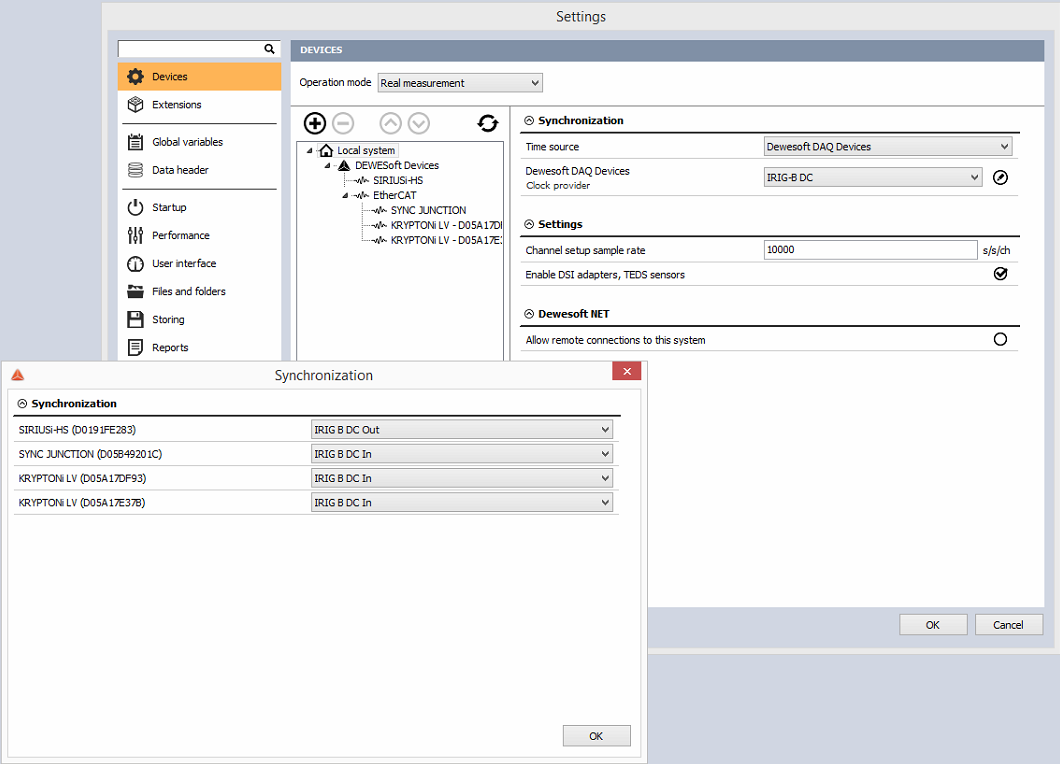

Would it be possible to get the screenshot of the settings screen (like attached)?

Attached is the settings screen as requested.

usually the Could not start acquisition (absolute time does not match) warning appears if the absolute time of USB and EtherCAT devices doesn't match.
Usually this issue appears, because the sync cable between Sirius and Sync junction is missing.
Since you are using DEWESoft USB and EtherCAT devices together, we would recommend you to use the latest SP7 and upgrade all devices to the latest firmware with the tool inside DEWESoft.

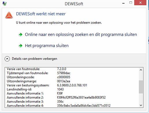

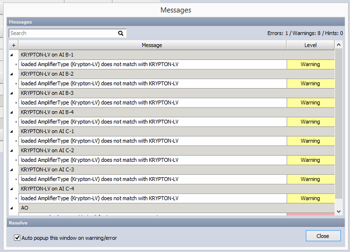

  • Still, SP7 gives me setup errors; see the attached display. I think this warning is a bug? The system seems to work OK.

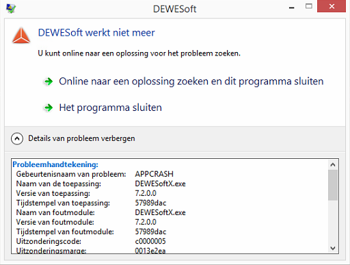

  • When I close Dewesoft, Dewesoft crashes. See the attached screen displays.
Perhaps the errors I mentioned are something you may want to investigate.

the error and warning messages only indicate that the connected hardware doesn't match the one in the setup. The setup will still work normally.
About the crash on close, I haven't seen this before, so I would like to ask if you send an e-mail on support and we do a TeamViewer session.
