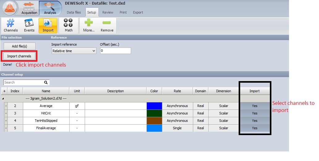

you can use the import option to import channels that you want to compare. Another option is to export both datafiles and open them with 3rd party software.
I attached a image showing how to import channels from one data file to another.

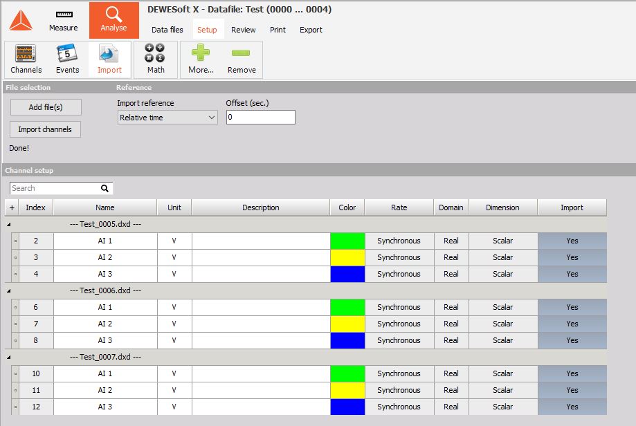

Hi, it is not possible to directly import a multi file into another multi file, but you can open a multi file and then import individual files of the second multi file.
In the bottom picture is a simple example, where I created two multi files one from Test 0 to Test 4 and the second from Test 5 to Test 7 and then imported the second one into the first one.
I hope this is the answer you were looking for.

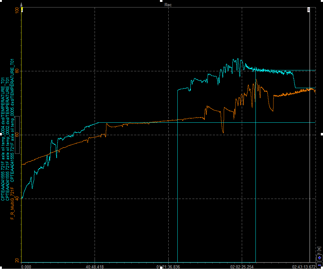

Hi, the problem with importing individual files, is the graph looks bad. I have attached a picture. This is something I do every day. We need to be able to compare 2 data files that are multi files. What is the point of using a multi file if I can't compare it to another multi file. Every day I test a machine with setup A. Then I change something, and I use setup B. Then I need to graph them and compare them. I recorded the time it takes me to export a multi file to a normal DEWESoft file, then import only certain channels I need to compare, and for a 1,000 Hz sample rate and a 2.5 hour data run, it takes me 13 minutes for the exporting and importing the data just to graph it. With our HBM eDAQs I can use infield, and within 5 seconds, I can compare 2 different data runs that are 4 hours long. Can something be done so I can compare 2 multi files without having to export them to a non multi file? I think lots of other people compare 2 different multi files.
