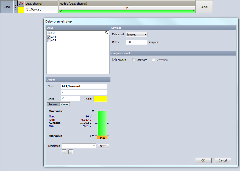

Hello,
Do you know how to change time lag for a measurement channel?
II would like to do A1(t-lag).with lag in second for A1 channel.
DEWESoft Support
Posted on 24.05.2016 15:03
it is possible to delay the channel with the "Delay channel" math.
The output channels can be delayed in samples or time(ms).
In the attachment is also the screenshot of the math.
