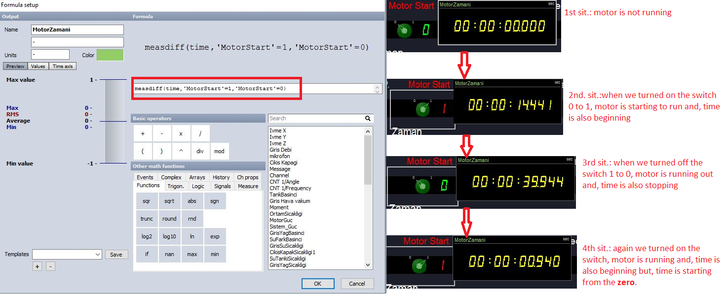

I'm using Dewe43A and DS-Net (Control Module), and my dewesoft version is Dewesoft X2 SP8. My question is about to counting time while motor running.
I want to count my time, when my actuator started. I can do this with 'math', but my problem is: time is not pausing (is stopping), when I stopped the motor, time is stopped also when I started motor, time is counting again. But it is beginning to count from 0 (zero), and I want time to continue. (I attached a video and image related with my problem)

in the attachment is a zipped setup file as an example.
For this setup to work, the "sample count" formula needs to have time axis timebase to sync.
