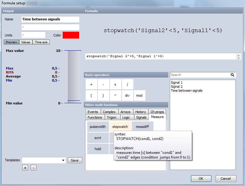

I am planning to use our Sirius to calculate the speed of an object crossing two optical barriers spaced with X mm. Each barriers is plug on a channel. When the object crosses one barrier, the signal falls from 5V to 0V. Is it possible with Dewesoft to automatically calculate the time between each falling edge in order to calculate the speed?

yes, this can be done with the use stopwatch function in formula.
In the attachment is a setup file as example.
