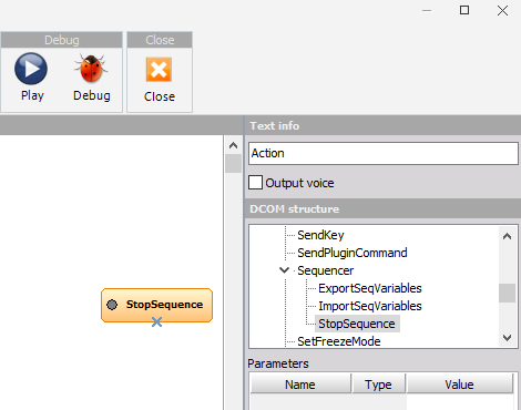

I'm sorry for the misunderstanding. I totally forgot that you can't leave an open line in a custom block. It will just continue with the execution. I've spoken with the sequencer's developer and he agreed to add an action that can stop the sequence. I'll let you know when it'll be available.
I've just tried out the new feature after it had successfully passed our automated tests. You can find it under the action block, sequencer and then finally the stop sequence option. It will be included in a new X3 SP3 version, which should get uploaded to our website today, or at least by the end of the week.
