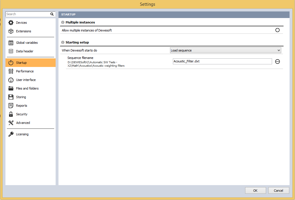

Is it possible to start sequencer setup automatically, when i open dewesoft X2 software. I mean how can the sequencer setup be started after opening the software?

To start a sequence automatically after opening Dewesoft you must go to setting, then startup and in starting setup select the option "When dewesoft starts do Load sequence" and select the setup you want to load. An example is in the attached picture.
