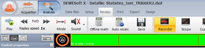

if you would like to split a file that has already been recorded, then you can export each triggered area to a new file. I'm guessing that your storing type is "fast on trigger"? If that's true, you can press the trigger button (attached picture) and use the arrow key to move through the triggered areas. You can then export each part to a new DEWESoft file individually. It will take some time, but I think this is the fastest way to do it.
