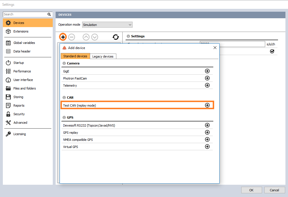

yes, that's true to an extent. The math channels are red because they are referring to non existing channels, which means that your CAN channels are not only not being simulated, they aren't even defined. When adjusting the simulated devices in DEWESoft's settings, you can press the plus button and add the "Test CAN" option.
You will have to load the setup again and this time all of the CAN channels will be defined, but as you said, no data will be simulated. All of the math channels should now turn back to normal. If some of them are still red, you might still be missing a few channels from the original setup. To see these channels, you can open the "Setup messages" window, which will show you the discrepancies between your current and original setup.
