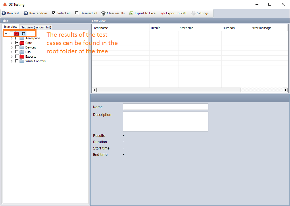

About the second issue, the sequencer doesn't have a block to export its results to excel. However there is a workaround, but the file will be an .xml and not an excel file. The workaround would be to open the DS testing tool (in the setup files tab press ctrl+shift+S -> it takes some seconds to launch), with which you can select a folder with all your sequences (Settings button) and you are then able to run them all at once. The results of all those sequences and test cases can be then found in the root folder in a file called "DSMainUnitTesting.xml". The attached picture shows how this tool looks like.
