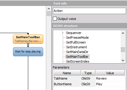

In order to play the data file, you should first load it and then use the SetMainToolBar function, as is shown in the attachment. After that, you can use the wait block with the Wait for stop playing option, which will cause the sequence to pause until the file has been played.
