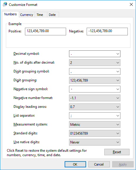

unfortunately there's no way to change the comma to the decimal point and vice versa through the calculation block. What you could however do is use a workaround. DEWESoft doesn't actually have fixed settings for using the comma or the decimal point, but rather uses the Windows's settings.
This means that you could manually change the "decimal symbol" in Windows in order to get the calculation block to produce values with a decimal point, which you could then transmit to your device.
I've tested this on my PC and was able to get the expected results. Please let me know if this is a valid option for your application.
