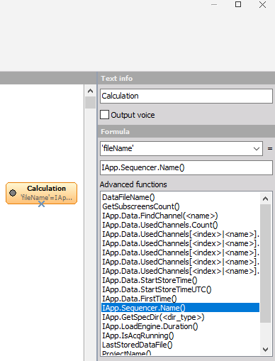

Is there a way of determining the name of the sequence file.
I know there are functions in the Calculation block that returns the name of the data file name and setup file name, but what about sequence file name?

there currently isn't any way of determining what the name of the sequence file is. I'll add it as a feature request.

the feature that you've requested in this forum thread has been added and is available online in DEWESoft X3 SP3 DEV-180302. You can now read the name of the sequence file using the calculation block. I've attached an image example of the function.
