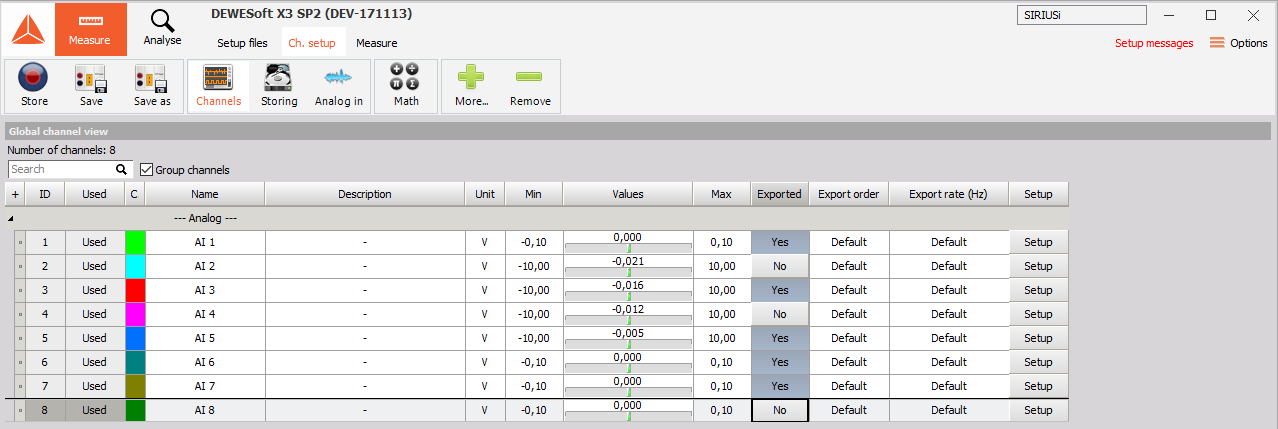

Dear Eric,
I agree with you that "Exported" column is not available under "Math" module - see a referenced screenshot.
However you can modify all Math channels under "Channels" module also. So what you have to do is to add the Channels and there enable "Exported" column. See a referenced screenshot below.
