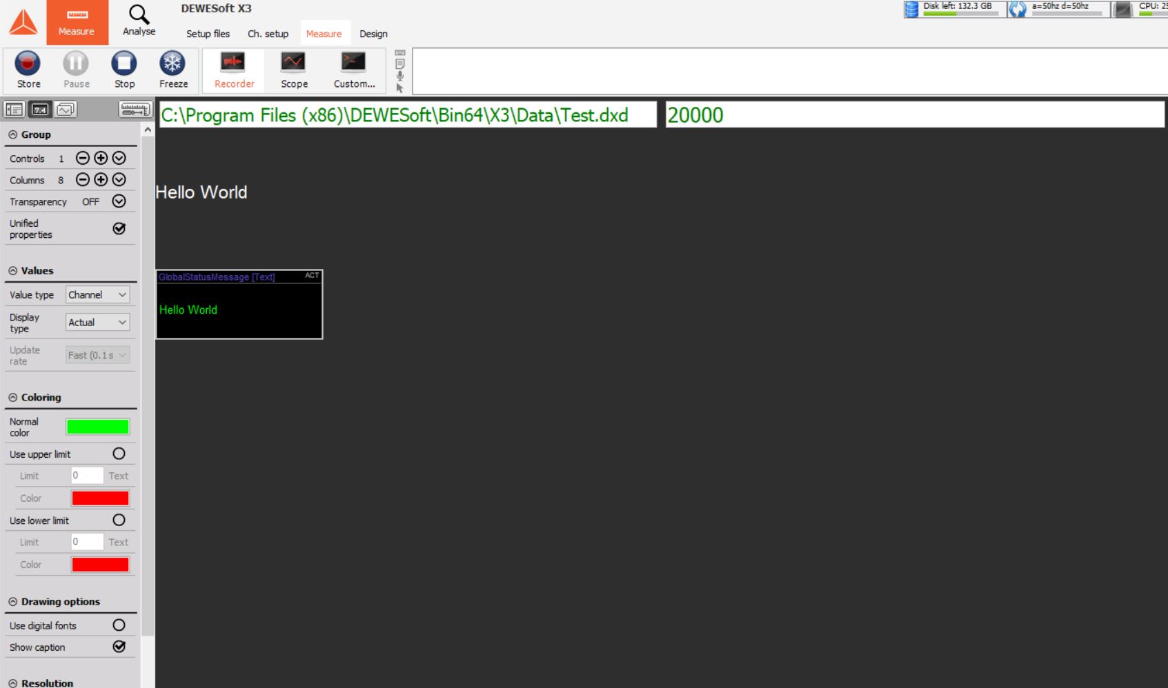

Is it possible to record all of the values, a text (string) type variable has had to *.dxd file?
Upon trials, it seems to be holding only the last value.

unfortunately you're only able to have single value text channels in DEWESoft at the moment. If you'd like to see different text messages across the timeline, then you can press the n button to add a user note. You however won't be able to export the notes.
