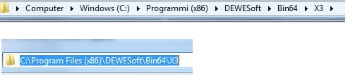

Posted on 22.11.2017 08:34
Good morning,
I believe that the issue is related to the translation of windows (from Italian) and the addresses with the spaces.
Attached you can find my case.
With the sequencer installed on the instrument the problem is solved( before was on pc with simulated mode)
thank you
Simone

Simone Bocchi
Posted on 22.11.2017 15:07
the issue is still present if I launch the sequencer on my pc( the screenshoots in the message before are coming from my pc and they are to explane how windows translate the path), but if I launch the sequencer on the sirius Sbox( different position on HD and English windows installed) works fine.
thanks SImone
DEWESoft Support
Posted on 23.11.2017 13:50
the problem is that the batch script wasn't able to use file paths that had a space in the name. I've modified the script a bit and it should now be able to use that file path.
