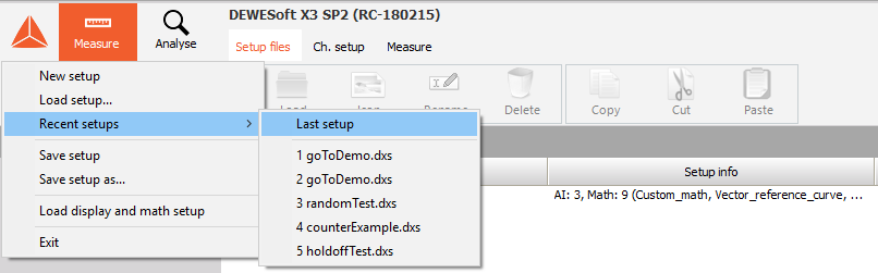

In the meantime, we actually already have a similar feature in place, which allows you to recover accidentally unsaved data. The feature is called "Load last setup", and it allows you to load the last setup before DEWESoft was closed. Therefore, if you've modified your setup but forgot to save it before closing DEWESoft, you can re-open the program and use this feature to retrieve your progress. I've attached a picture which shows where you can access it.
