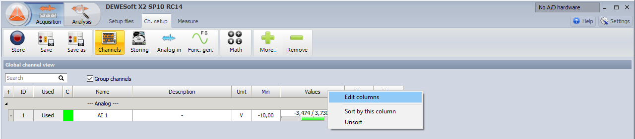

by default in the export tab all the channels are selected for export, however you can set which channels will be exported in the setup file. To do this you click on the More.. button and add the Channels option, right click on the top of the table, click edit columns and select the exported option. If you add this, you can set which channels will be checked for export in the acquired datafile. In newer versions of DEWESoft, the export of global variables is set in the settings, so in the Global channels view, these channels will be greyed out.
So like you said, the channels that will be exported are defined in the setup file, that you load at the beginning of your sequence.
