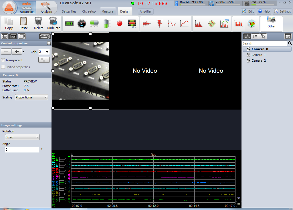

Thanks for replying. I can set up multiple cameras but now have a different issue.
When using the S-Box at default camera settings (YUY2, 640x480, 30fps), only 1 video channel will work, the other 2 show "no video."
However, if I reduce the resolution and fps to (320x240, 15fps) all 3 cameras will work.

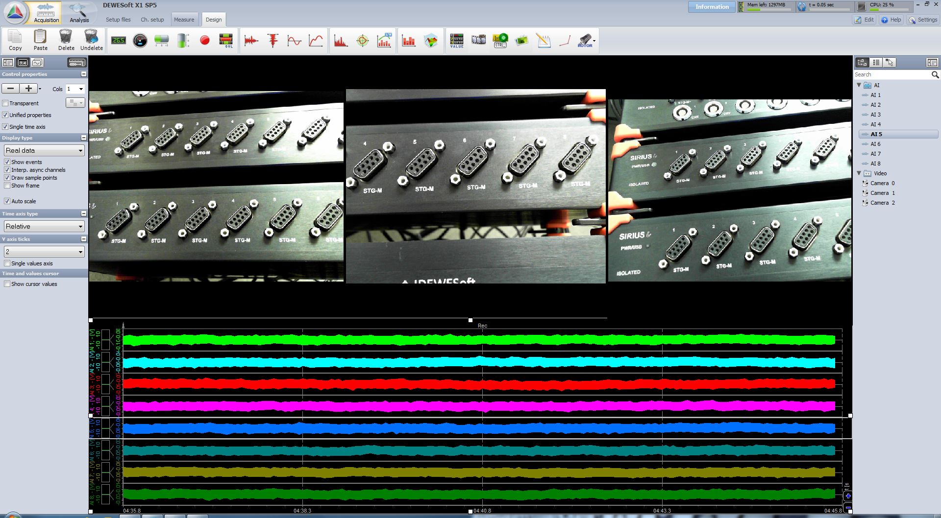

In interest of curiosity, I hooked up the same 3 cameras with a Dewe43 on my laptop and they all work at the default settings (YUY2, 640x480, 30fps) with no issues.
The laptop/Dewe43 combo is running Win 7 64bit with Dewesoft X1 SP5, the S-Box is running Win 7 32bit with Dewesoft X2 SP1.
