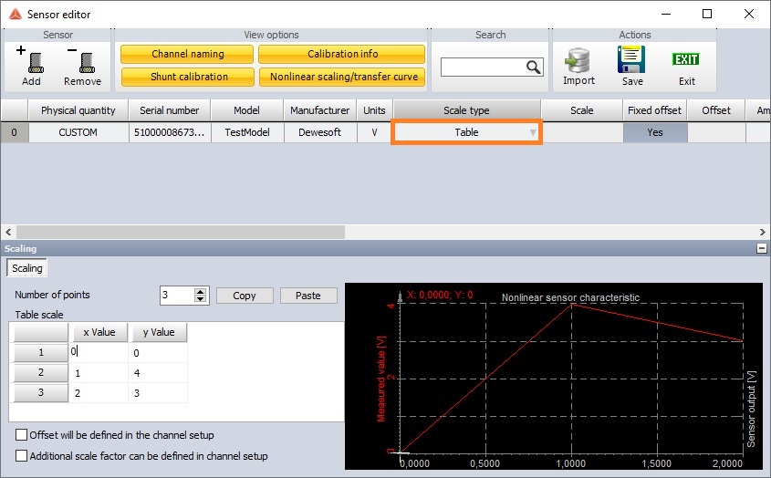

I was wondering if there was a way to set up the system to do a multi point calibration instead of the 2 point calibration. Our older DAQ system allows us to up to 10 points of calibration for our load cells and string pots. Is there a way to do the same thing with the Dewesoft?????

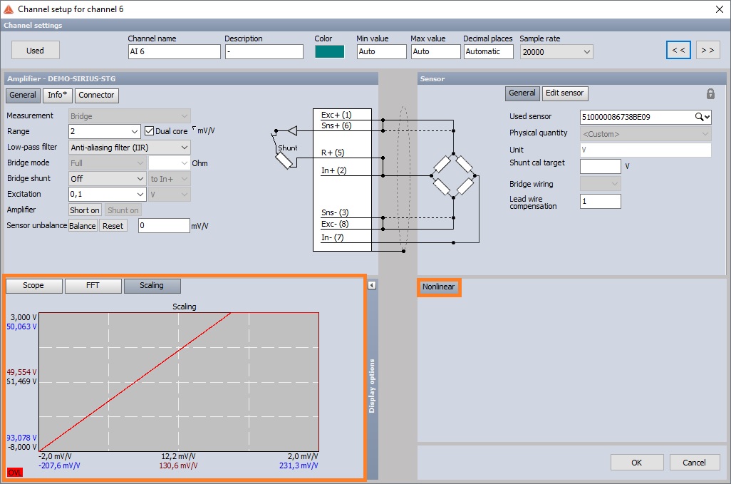

yes, you can calibrate sensors as linear or nonlinear. In the case of nonlinear, you can use a table or a polynomial function. Linear sensors can be defined through the channel setup interface, while non-linear sensors need to be defined in the sensor editor.
Therefore, you can first define a sensor through channel setup, then access it in the sensor editor and set the scaling table as you please.
I've attached some pictures that you can use for reference, but there's also a PRO training about the sensor editor which you can use as a source of information if you get stuck on something.
