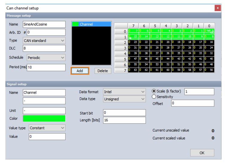

Hi, i have Lem Cab 300-c/sp2 current sensor. But i can't define messages in DewesoftX2 with Ds-net.
I share sensor datafile. Is this can informations enough ?
Thanks

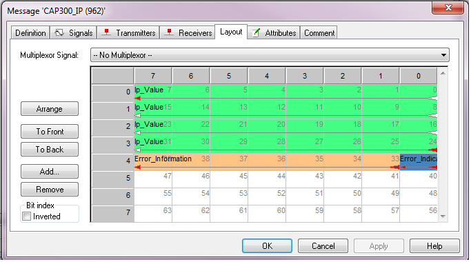

Data Sheet to SP2 is here http://www.lem.com/docs/products/cab_300-c_sp2.pdf

Thank you, yes different message id. But i still cant.
How can i set can channel setup ?
Thanks
Michal Nawrocki
Posted on 21.08.2017 15:31
I'm using different tool for creating the message layout. If that configuration will work then we can try to create it in DEWE (it shouldn't be difficult :) )
If not working, tomorrow we can try fix it.
