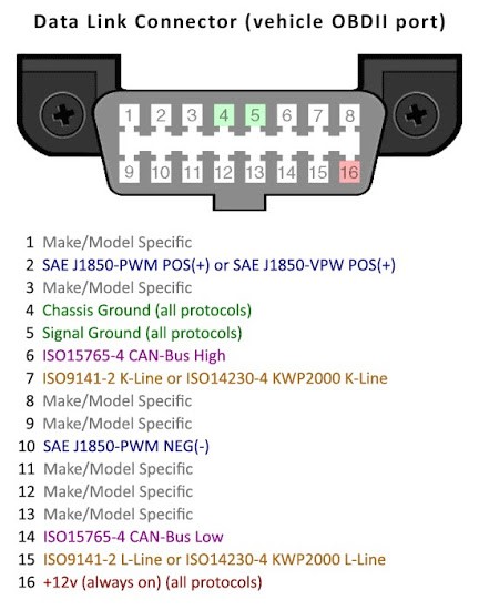

We would like to gather data from a vehicle that uses KWP2000 at its diagnostic port rather than OBD-II.

KWP uses the ISO 9141 physical layer. On the J1962 connectors the K and L lines are found on 7 (K) and 15 (L)

unfortunately the diagnostic protocol KWP2000 isn't supported in DEWESoft.
