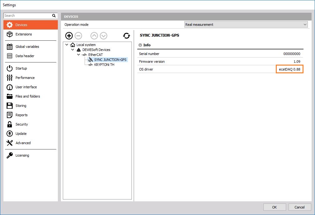

since there is a Krypton DI/DO in the EtherCAT chain, upgrading the software to the SP9 release could resolve the problem.
It is also possible the problem occurs because of the high cable lengths or EtherCAT driver.
Can I ask what are the cable lengths and which version of the EtherCAT driver is used?
