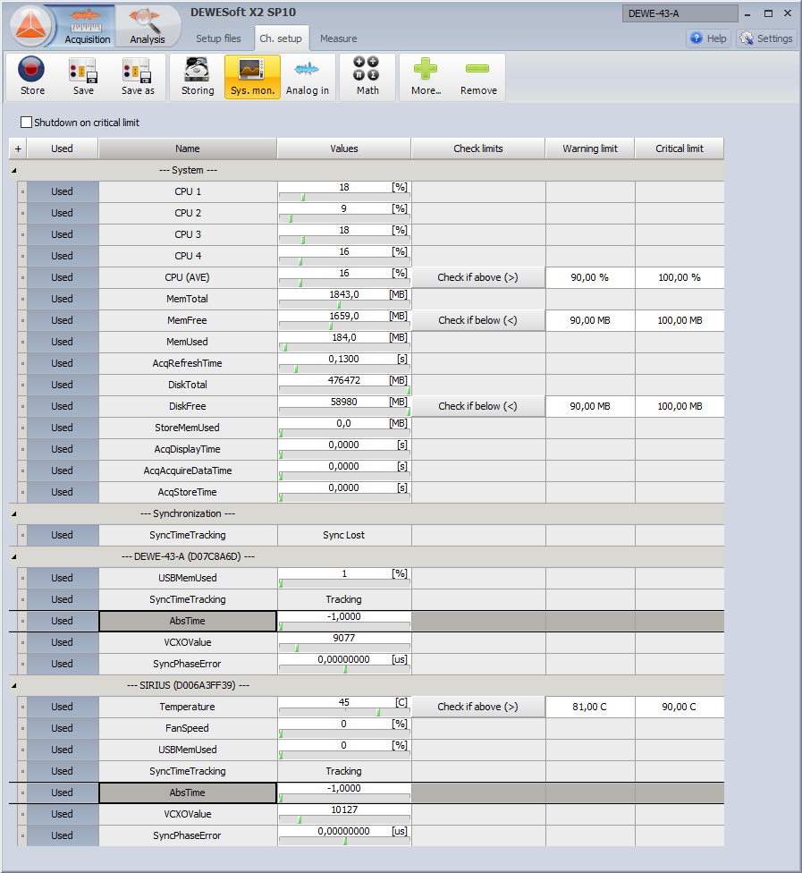

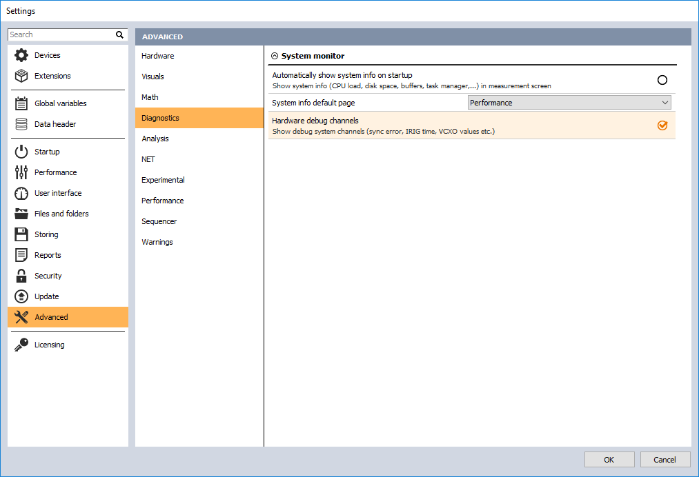

I just learned that this has already been implemented in the past, but I couldn't find it before because it was hidden inside advanced settings. I've attached two images which show what where you can enable this channel and where it will show up inside system monitor. This feature is present in the current release version X2 SP10 b18, so you can already use it.

I enabled this channel thanks to your screenshots.
I tried to see the IRIG time on the user interface with the tag <CHANNEL VALUE NAME=AbsTime> but the IRIG time is not updated, it keeps displaying the same time (since DEWESoft was launched ?). And the format is not "good", IRIG is meant to show the day number, and here it is a date that is displayed like "04/07/17 16:35:01.545".
