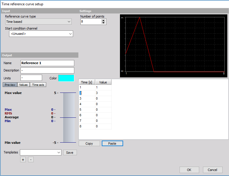

Hello,
I would like to set a complicated time based reference curve in the "Time Reference Curve Setup" panel of the Math Module.
I would like to paste/load data from a txt file (or from excel sheet), but I can't do it. Is there a way to do it?
My aim is to have a signal imported from an external source (also matlab) and use it as an output channel.
I also accept suggestions for alternative ways to proceed.
Thank you,
Giuseppe

Posted on 22.01.2018 08:23

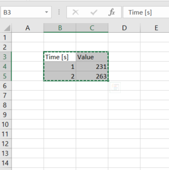

the copy/paste feature can be used to import the data from text editors or Excel sheets, you just need to make sure that the header matches the one that's written in DEWESoft. I would recommend that you first copy the data from DEWESoft and paste it to Excel to see the correct format. Then you can use that header with your data and paste it together back to DEWESoft.
Please let me know if you'll be successful in configuring your data.
Giuseppe Mat
Posted on 22.01.2018 09:56
perfect! It's working.
It is not possible to paste without headers. So it is sufficient to give a header to each column like in the attached figure.
Thank you so much,
Giuseppe
DEWESoft Support
Posted on 22.01.2018 10:22
it's no problem. Yes, that's correct.
