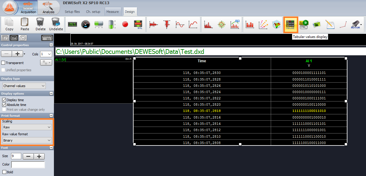

For the time being, you can still use the "Tabular values display", which will correctly show the binary data. I've attached an image which shows how to select it and configure it. If you want to imitate the digital display, you can remove the time column and only keep one line.

Thanks,
I can use this solution !
