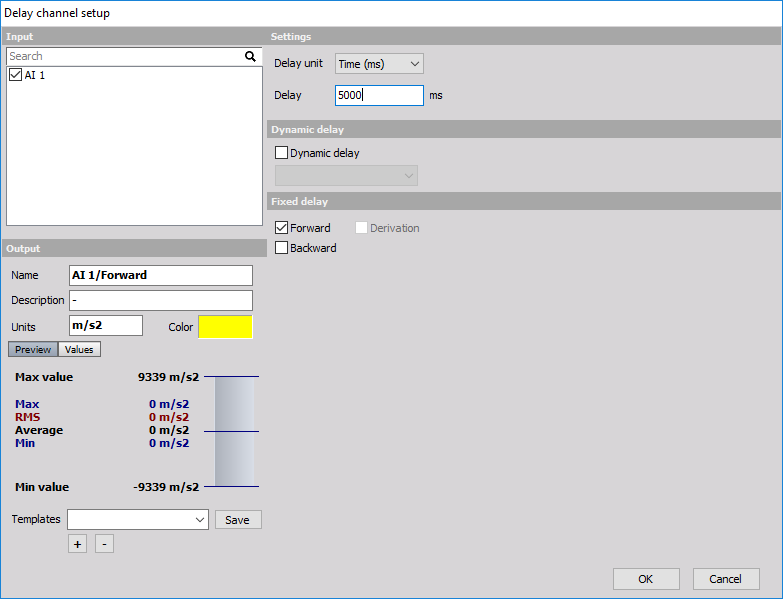

DEWESoft has an easy way to do this. In math, simply search for delay and you'll be able to access the "Delay channel setup". I've attached a picture that shows you this option. There you can define your delay in terms of samples or milliseconds.
If you'd like to avoid an additional channel, then you can also define the delay in terms of samples directly in a formula. Simply add an .data(i) extension to a channel, where i will be the sample number in reference to the current time. The sample index of each moment is 0, so you would need to write in -XXX, depending on your sample rate to access previous samples.
Let me know if you need anything else.
