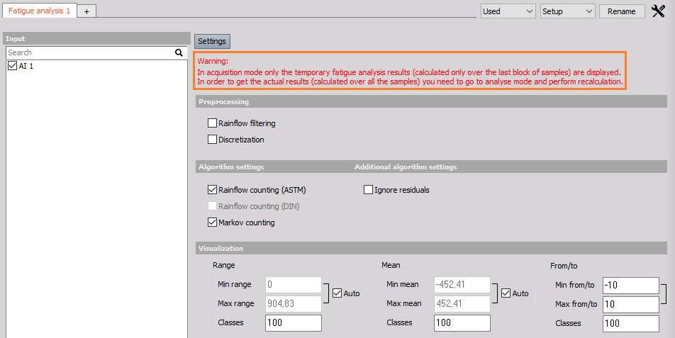

Hello,
Is there a way to increase the amount of time the fatigue tool will plot? looks like the plot starts over about every 2-3 seconds..
I'm looking for more of a cumulative plot not a scrolling one.
-Thanks
DEWESoft Support
Posted on 06.11.2017 07:37
during the measurement, fatigue only reclaculates the lat block of the samples, that is also why the plot starts over every couple of seconds.
For the correct results, the fatigue math needs to be recalculated in offline mode.
