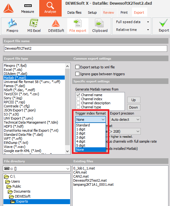

I am currently working at a project for which we use Dewetron/Dewesoft for the data acquisition of our measurement runs.
But we face a problem with the export of the data as mat.file.
After the export the prefix "Data1_" is added to the names which causes a cut of the name at the end.
As I could figure, the length of the channel name is limited to 31 characters.
e.g.:
"DAP_GNSS_StdDev_Spd_East_ST3" <--> "Data1_DAP_GNSS_StdDev_Spd_East_"
Is there a way to extend the limitation of characters or to switch off the prefix-adding function?

you can switch off the Data1 prefix by setting the Trigger index format to 'None' (see attached photo).
thank you very much for your help.
I figured out that we were using the older DEWESoft version 7.1.1 . After installing the latest X3 version the export worked well.
