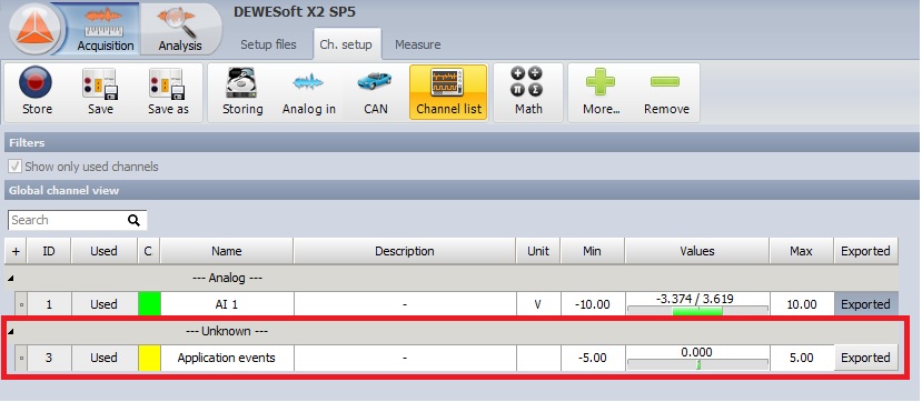

Hello, since whenever, I have weird channel. What is this?
How can I remove the channel?
NVH Application Engineer
This channel contains informations about all application events such as data lost, errors, whether a device has been disconnected, etc. .
Unfortunately, it cannot be removed. It the measure mode it is only seen when an event happens.

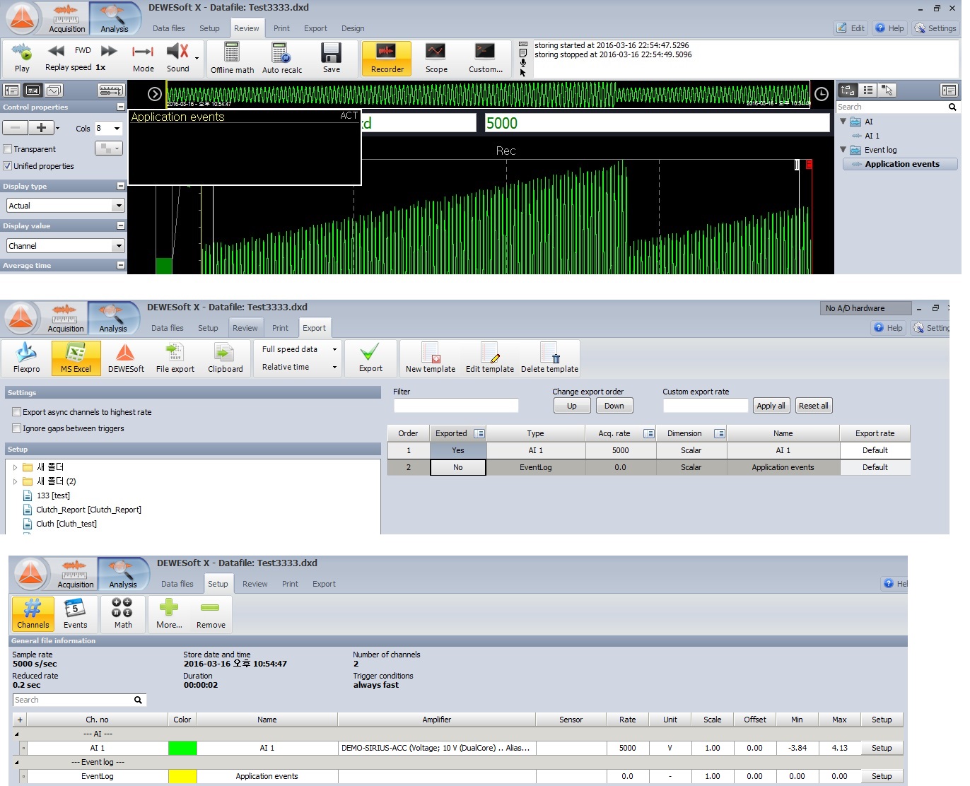

Thank you for the answer.
There is the channel in measurement and even export screen although there is no event.
The channel will be included in every data file. Is this correct?
Software Test Engineer I
Hello,
The channel application event is still in the newest version of SP/, but it only appears if there was an event.
So if you have zero events during a measurement this channel won't appear in your data file. In your version the channel will be included in every data file, but in the export screen it is set to "no" for export by default.
