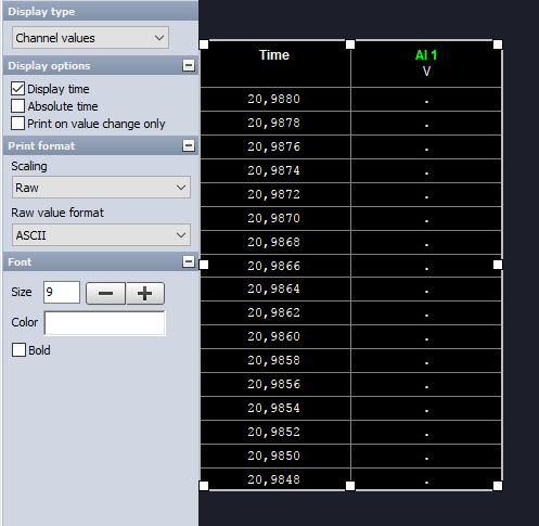

Posted on 23.11.2017 10:37
DEWESoft is currently unable to convert ASCII encoded data into a channel. What you can however do is still display that data. If you use the tabular values display visual control, you can select the raw scaling and the ASCII format. This means that you can monitor the values, but you can't use them in any formulas.
