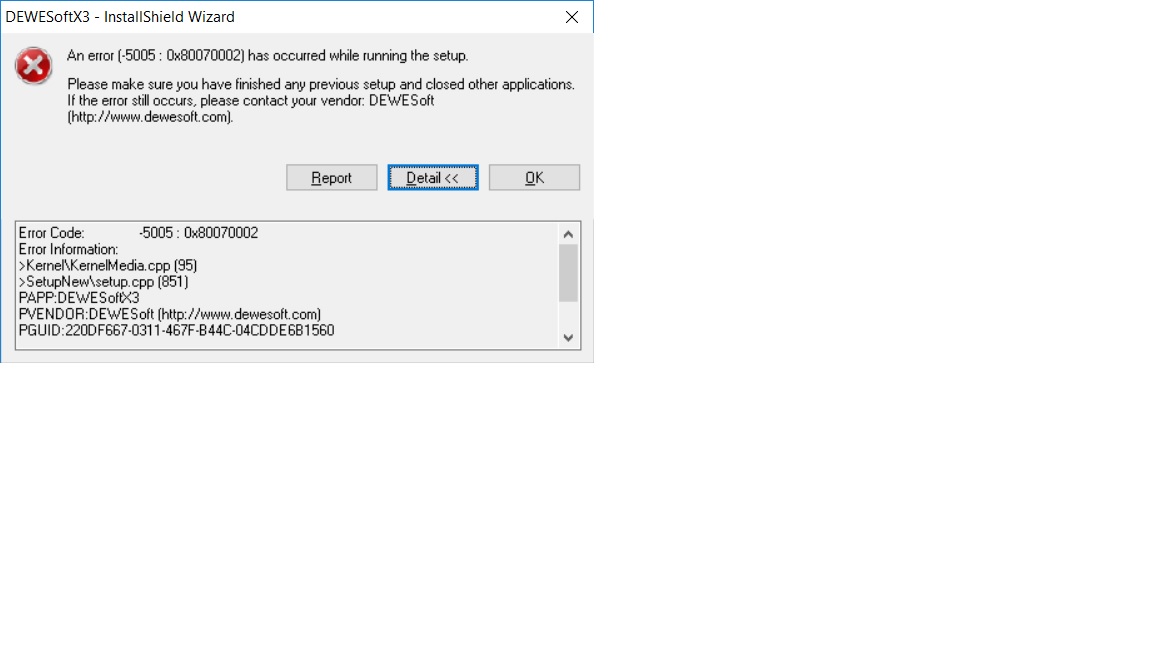

I use Dewesoft X3 64 bit. As the 64 bit doesn't support most of the plugins, I tried to uninstall 64 bit and install 32 bit version.
But while uninstalling the 64 bit version, I get an error message (see attached). Please can you help?

I do not recollect removing any files knowingly at least. Does the error code in the picture attached mean anything to you.

unfortunately the error doesn't mean much to the development team here. I've attempted to reproduce the problem several times, but haven't had any success.
