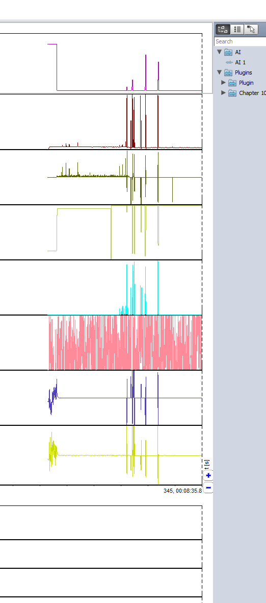

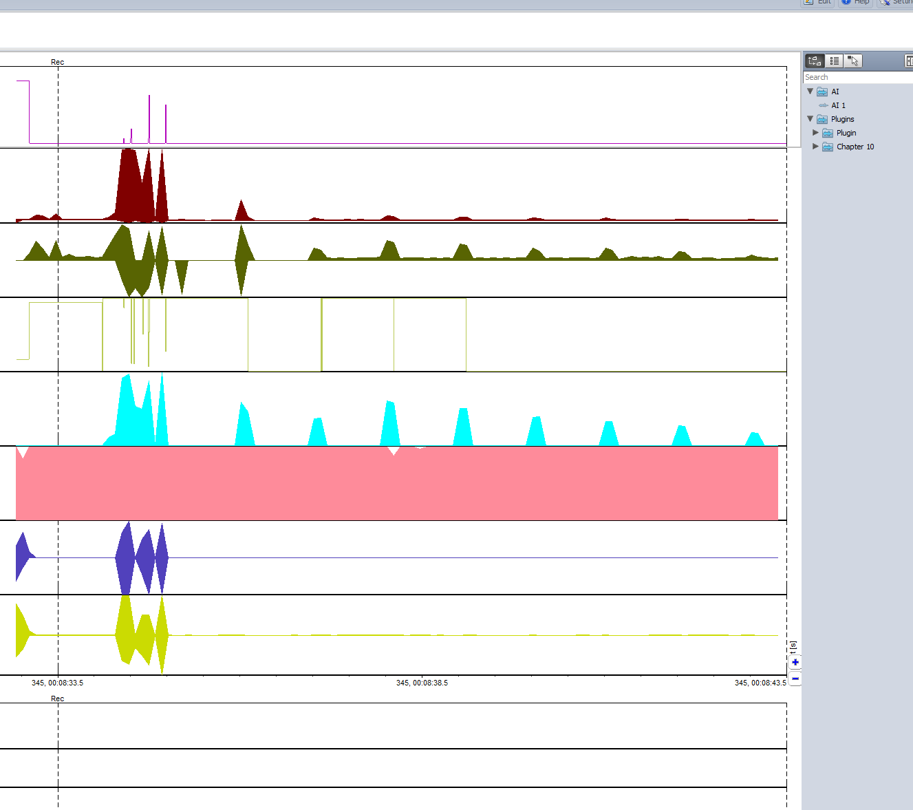

Whether I am in acquisition mode or Analysis mode, our wave form display constantly change to this "Filled in blob" look after about 10 seconds of playback. This happens on several different PCs. Is there a known cause of this? Is there a way to fix or adjust it? See attached screen shots.
The Start "image" looks normal, then after a while all displays change to the overfilled, blob view which I called "Glitch"

this happens when the buffer changes from direct to intermediate.
Unfortunately, it can't be adjusted when the buffer will change, but it is possible to increase the static acquisition rate.
This will increase the resolution of displays.
