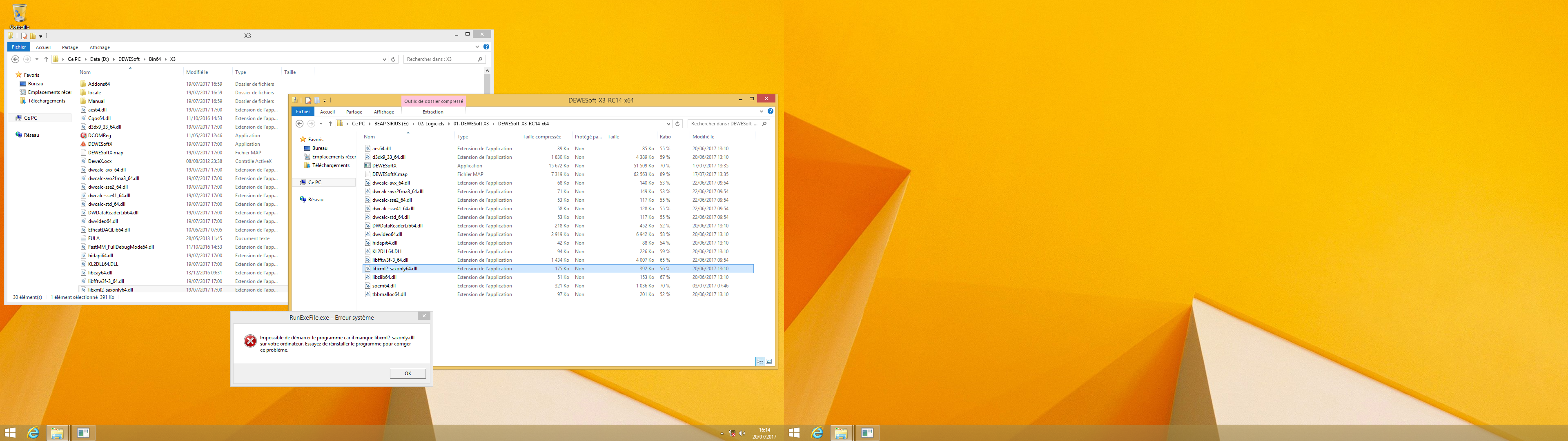

Hello Anže,
So I forgot to precise that I installed DEWESoft X3 64 bits !
I had a look at the forlder, and indeed there is a DLL named "libxml2-saxonly64.dll" in both Bin64/X3 folder and binary zip file (see screenshot joined).
I tried to rename this DLL to "libxml2-saxonly.dll" but it didn't work. I think it is still waiting for the 32 bits DLL.

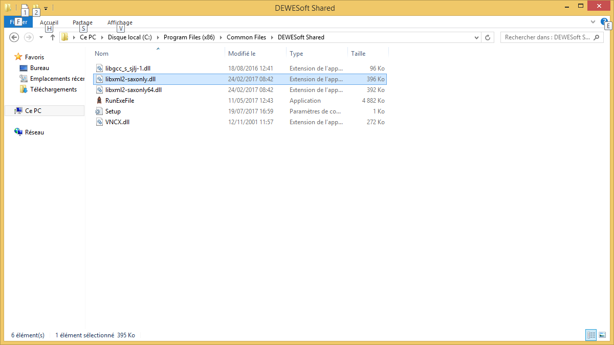

So, I found out that RunExeFile.exe was located in :
C:\Program Files (x86)\Common Files\DEWESoft Shared
I looked at it in my computer where DEWESoft X3 was installed, and indeed there was only the "libxml2-saxonly64.dll" DLL installed.
I copied the "libxml2-saxonly.dll" I had on another computer with the latest DEWESoft X2 installed. And it works fine now (look at the screenshot).
I think the DEWESoft X3 installer doesn't include the "libxml2-saxonly.dll" (which is a 32 bits DLL). The installer provides a 64 bits DLL in the 32 bits (X86) folder of Windows. Weird !
