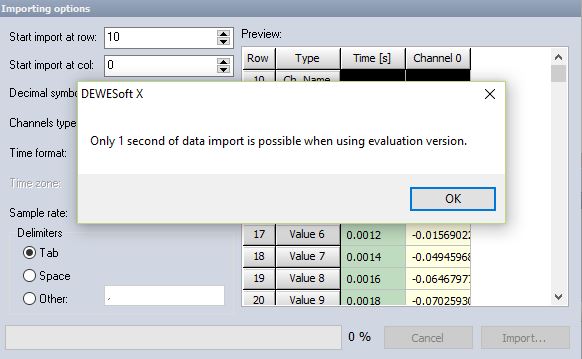

okan yücel
Posted on 27.05.2016 14:05
When I want to import *.txt I have problem likethe picture below. Could you help?
