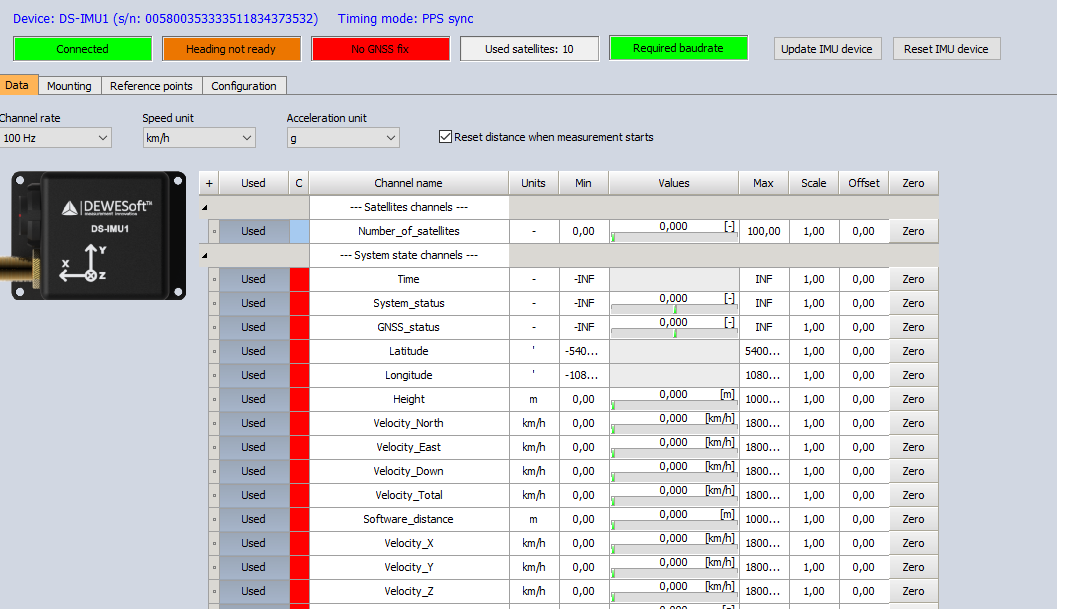

hi,
today I am trying to do some tests with IMU 1 and gps module. when I set everything is settings and go to IMU channel setup all warning boxes are green and looks fine. Collected data is correct etc. However, when I go to measurement mode or change to any other screen and return back to ds imu under channel setup, I got the error message saying that the `No gnss fix` and the used channels are all frozen. When I plug and unplug the IMU usb, channels start showing data but error still stays. It seems like the problem discussed in this topic is similar to what I experience. I can only collect data only after usb plug and unplug. It seems like the device shows as not connected. Thanks. Mert
