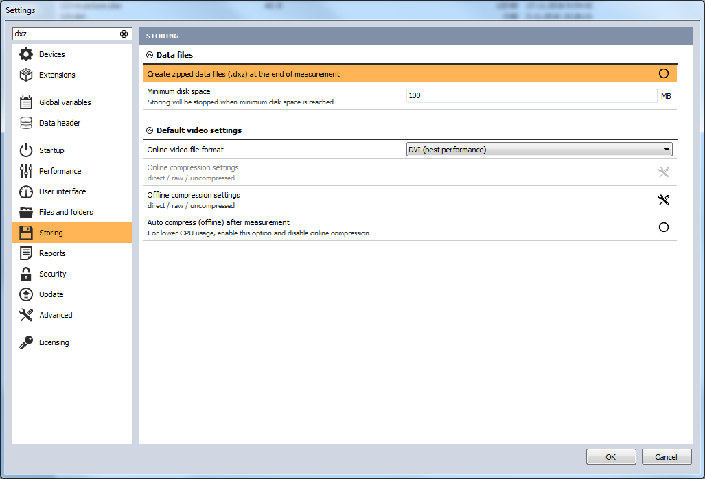

1. In the settings the *.dxz files can be enabled. After the end of the measurement, the data file is zipped.

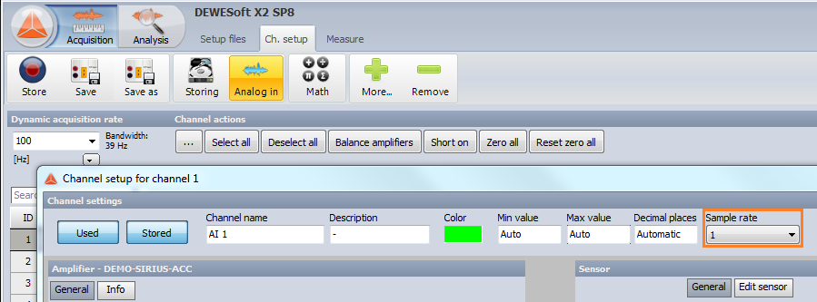

2. It is possible to lower the sample rate using the sample rate divider in channel setup.

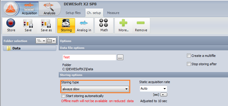

3. It is possible to use always slow setting in storing tab.
