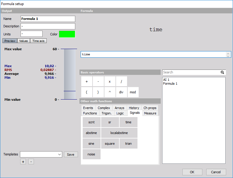

Is it possible to get the Current Date and Current Time as a channel?
I know you can set a visual control to show the current date and time by setting its Value type, but I would like them as a channel instead, so that I can do some calculation. Is this possible?
you can add time as a math channel. There are three options to chose from: "time", "abstime" and "localabstime". Time will output the relative number of seconds, while the other two will output the number of days since the 30th December of 1899.
