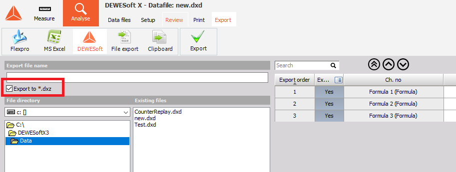

Just wondering if there is a method to convert a dxd to a dxz?

yes, you can do that by exporting to Dewesoft and selecting the "Export to *.dxz" option (see attached photo).
