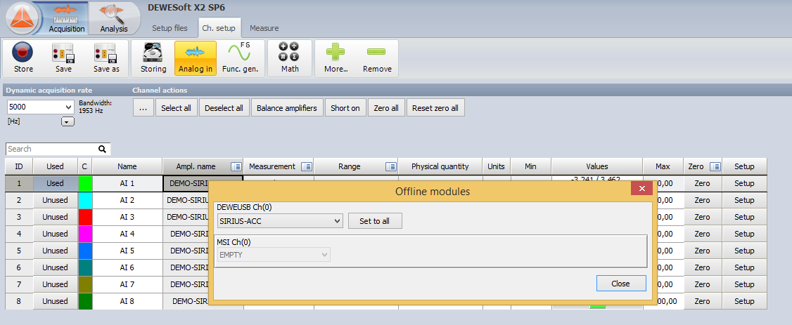

Dear Tim,
these errors just indicate that the inputs on your computer without hardware don't match with the ones with hardware. It isn't a big error. You can open the setup in simulation mode and set the inputs to match the ones you use with the hardware. To do this you need to right click on the amplifier name and click on offline setup. A pop-up like in the attached picture should appear and here you select the inputs of your device. You can than freely edit and save the setup, but once you reopen the setup with the hardware, the errors will appear again, because the serial numbers of the input modules aren't the same, but you can ignore that and re-save the setup. After that reopening the setup should not show any more errors. You can recheck the settings, but they should have stayed the same.
