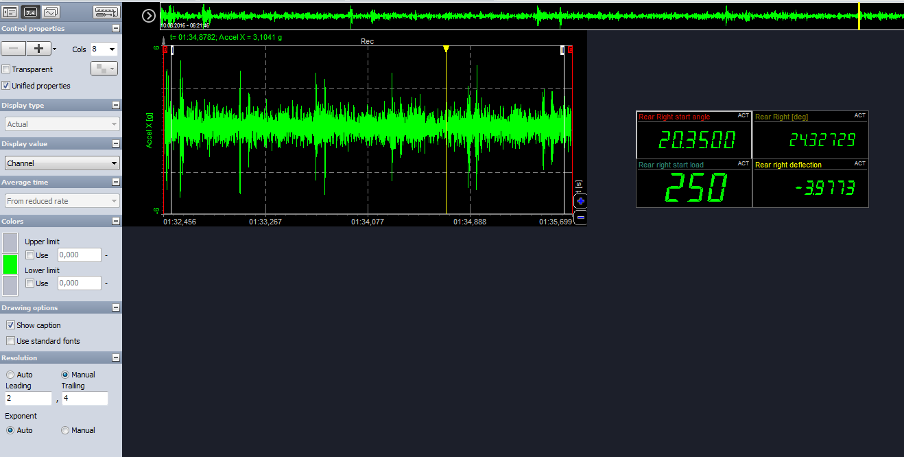

we have checked the data file and as it looks the value of "Rear Right start angle" is actually 20,35.
The decimal places on the digital meter can be increased with the "+" button like on the picture bellow.
your rear right start angel is 20.35 and not 20.00.
Change the resolution of your display to manual with 4 trailing numbers.
