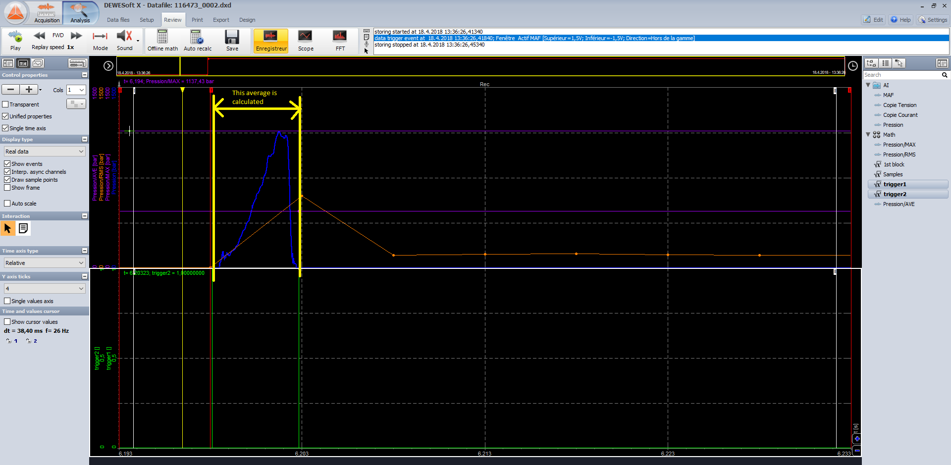

Urban Baš
Software Test Engineer I
Posted on 30.05.2018 10:34
I attached an edited version which calculates the average of the section which is marked on the picture. You can change this window by tooning the Trigger1 and trigger2 formulas.
Alexandre CHENIEZ
Posted on 30.05.2018 10:40
That wasn't that part, but I should be able to do something with your formula.
Thanks a lot for your fast answers !
