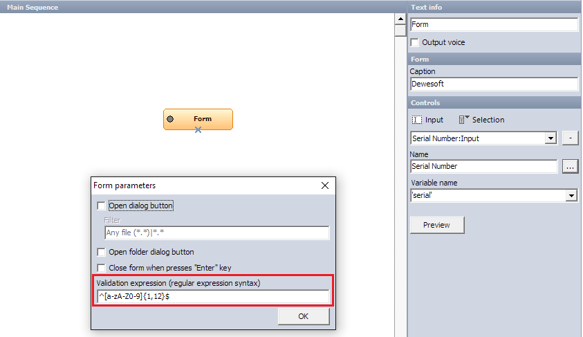

We have added a new condition in the form block - Validation expression. Please refer to the attached image. With the regular expression syntax you can define exactly which character are allowed and the length of the expression (more info about regular expression syntax here).
With the expression in the screenshot ^[a-zA-Z0-9]{1,12}$ we have defined:
  • small characters a-z
  • capital letters A-Z
  • numbers 0-9
  • length of text from 1 to 12 characters.
If you need a fixed length of 10 characters, the expression would be:
^[a-zA-Z0-9]{10,10}$
This update will be available in the next build SP10 RC14. Please check the downloads page for the update.
