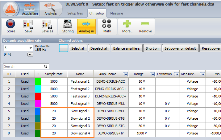

in the attachment is an example setup for the application you would like to do.
1. Select the measurement type to fast on trigger slow otherwise and set up the .
2. Apply the sample rate divider to all the channels which needs to be stored slow only (picture attached).
The setup file will store all channels slowly, but when the trigger will come, the fast channels will be stored with the dynamic acquisition rate (50 kHz).
