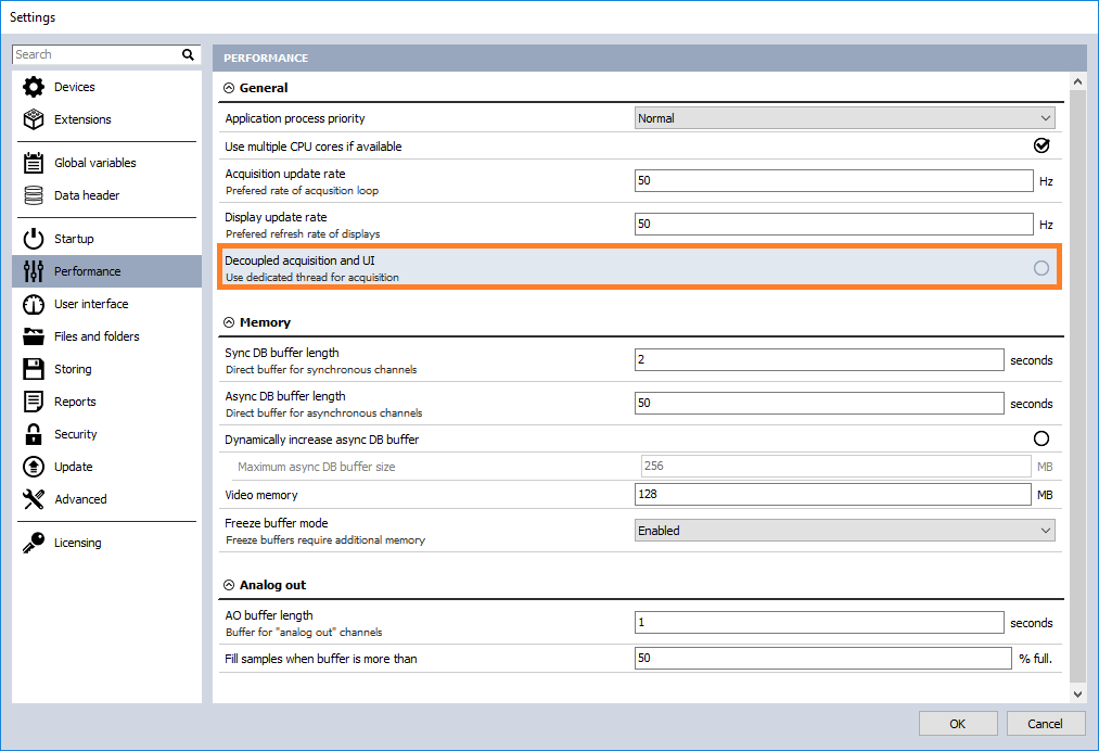

if you're using custom plugins in X2, you have to uncheck the "Decoupled acquisition and UI" option in DEWESoft's settings, under the performance tab. I believe that after you make this adjustment, your plugin from X1 should also function correctly in X2.

Thanks for your answer. I unchek "Decoupled acquistion and UI " as you described. But, I still have the issue, (even worst, since now, the visual control don't appear at all, DEWESoft freeze directly).
